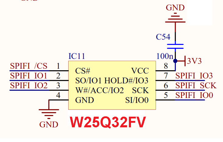

Hello to all. Sorry if my English is poor.
I have bought lot's of LPC4330 and now I see that there isn't on-chip flash in it.
Now I wanna to use external flash memory but I don't know how to use.
Is there easy way to use this microcontroller? Is there easy Memory IC with schematic to use that?
very thank you.

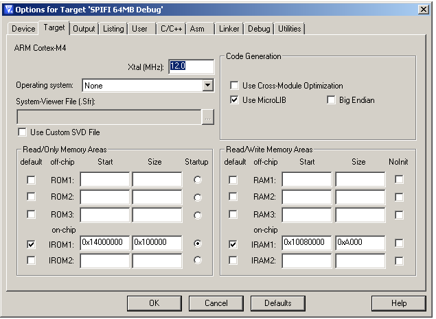

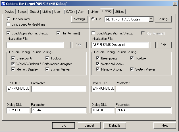

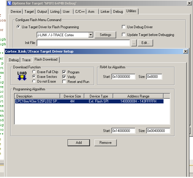

I've used W25Q32FV as Flash and I've programed the example of NXP LPC43xx-GPIO, but it has this problem. Does somebody know where my problem is?
Load "C:\\Users\\Leon\\Desktop\\lpc43xx\\Examples\\GPIO\\Gpio_LedBlinky\\Keil\\SPIFI 64MB Debug\\example.axf"
Set JLink Project File to "C:\Users\Leon\Desktop\lpc43xx\Examples\GPIO\Gpio_LedBlinky\Keil\JLinkSettings.ini"

Erase Done.
Programming Done.
Contents mismatch at: 14000000H  (Flash=FFH  Required=58H) !
Contents mismatch at: 14000001H  (Flash=FFH  Required=08H) !

Error: Flash Download failed  -  "Cortex-M4"1.png2.png3.png4.png5.png

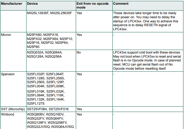

Can I use this IC for flash: W25Q16BV.
How can I use that?

soledad
Hello Leon,
You need to use SPIFI library. You can find more information in the following link:
LPC SPIFI Peripheral|NXP
For schematic reference, you can check the LPC4330 Xplorer board:
https://www.nxp.com/downloads/en/design-support/LPC4330_Xplorer_schematic_OM13027.pdf
Regarding the QSPI devices, multiple QSPI devices from various vendors can be used with the SPIFI interface and the SPIFI API available on nxp.com. The devices listed in the following table are tested to work as boot devices for the LPC43xx and with the SPIFI API.
Remark: All QSPI devices have been tested at an operating voltage of 3.3 V
