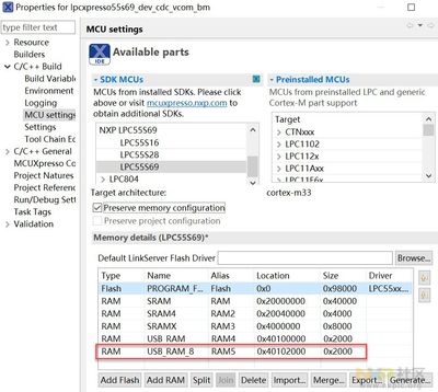

Hello hoberg,
There is a demo steps you can refer to:
1) Create USB RAM space to save data:
2) Initialize data to USB RAM:
#include "cr_section_macros.h"
__DATA(RAM5) uint32_t array[10];
3) You can check the address of “array”:
PRINTF("array address is %x\n",array);
4) Also can printf the data of address 0x40102000:
PRINTF("array is %x\n",*(uint32_t *)(0x40102000));
I attached the test project to you, you can have a look.
This project base on LPC55s69, the same method with LPC54628.
