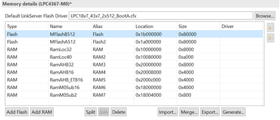

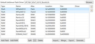

I am using LPC4367JBD208 Tri Core controller in out product development. So far we are able to use it in proper manner but the problem we entered is the shortage of on ship RAM.
The available on chip RAM is 154KB and and it is further divided with respect to the core allocation. Below is the memory configuration of Flash bank 1 (M4 Core ) and 2 (M0App)
M4 Core MCU Setting here You can see 40KB RAM is used for application
M0App Core MCU Setting. Here 32 KB RAM is used for Application
M0Sub Core MCU Settings. 16KB RAM is used for application
Now in this case the allocated RAM  for the respective flash bank 1 and 2 are not sufficient with respect to the application so need more RAM for the code execution. But then is it possible to use External RAM instead of On chip RAM for any one of the Core say M4 Core?

First, external RAM is driven by peripherals and IO lines, which means you need to set this peripheral and lines up before using them. For static use with the linker (and linker script), you need to modify the startup code to initialize it before RAM data are copied.
We are already using the SDRAM and assigning the specific data using __DATA(RAM8) attribute. But now we are planning to use it for entire application code execution.
Regarding the Startup code and linker script  implementation, is there any application note with respect to MCU xpresso will be helpful.
Second, you will need those interface lines, especially address and data lines. Are those free in your current design ? And does your derivate support expernal RAM at all ?
We already have interfaced the SDRAM as mentioned above but regarding the device support to use SDRAM as a external RAM instead of on chip RAM , is not yet clear since not able to find as such information regarding the same.

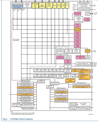

> Yes we are looking for the same purpose, but not clear regarding the internal connection to I-Bus.
The first indication would be an image like this in the datasheet:
The ext. memory peripheral section of the user manual should clarify if your MCU can execute code from SDRAM. As mentioned, I have no experience with the LPC43xx. And because of the 16-bit bus, expect at least reduced performance.
Perhaps the NXP experts can clarify this point.
