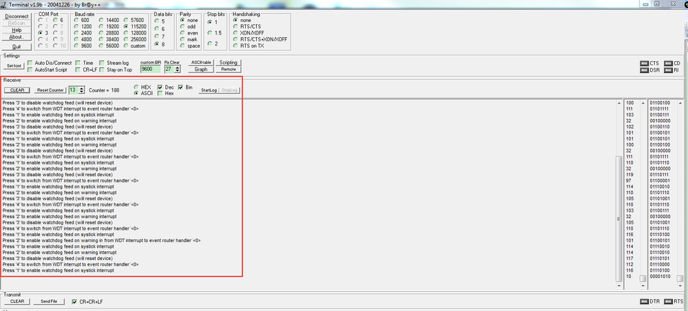

I've inserted the NVIC_SystemReset(); in the demo of the LPCOpen library, After running the demo project, I find that the MCU is available to be reset periodically
Below demonstrates I inserted the NVIC_SystemReset(); in the watchdog demo project.
