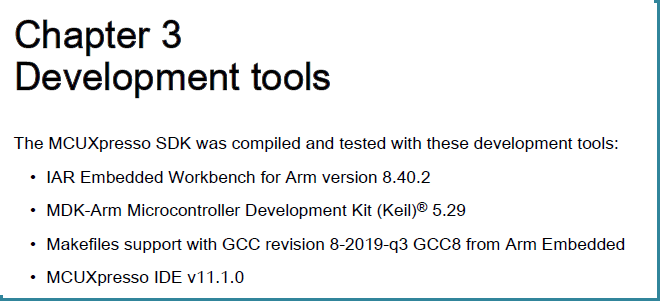

Hello, I downloaded the latest version of the SDK (2.7.0) for Windows, and KEIL IDE. When I compile keyboard2mouse USB example, I get the errors below. I do not get any error when building keyboard2mouse on older SDKs 2.6.0 and 2.5.0.
please advise.
*** Using Compiler 'V5.06 update 4 (build 422)', folder: 'C:\Keil_v5\ARM\ARMCC\Bin'
Rebuild target 'keyboard2mouse_bm debug'
compiling usb_host_framework.c...
Fatal error: C3900U: Unrecognized option '-fno-common'.
Fatal error: C3900U: Unrecognized option '-fdata-sections'.
Fatal error: C3900U: Unrecognized option '-ffreestanding'.
Fatal error: C3900U: Unrecognized option '-fno-builtin'.

ZhangJennie
Hi bob belmont
It's typo. Yes, I mean MDK5.29.
According to SDK2.7.0 release note under SDK install folder. it was only tested under below platform.
Thus the lower version MDK is not supported.
If you use MDK5.22, please use the low version SDK instead.
Have a nice day
Jun Zhang
