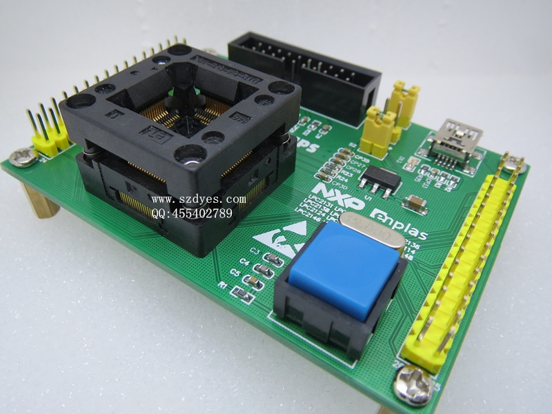

I have brought this device for programming LPC2148 now I am not able to program the IC using this module. And I am not able to find any videos for it how program the IC using this device. Can anyone please let me know how to program the IC using this device.

At a glance, it seems that the board of the picture is just a socket-pinout board with debugger connector, so, you should verify the following basic points:
  1. Target processor is properly powered.
  2. Debugger is properly oriented and connected on debug connector.
  3. Processor is properly mounted and aligned on the socket.

Please someone help me with this issue. Can anyone provide the schematic
of it.

Please help me by sending schematic of the programmer. Error is due to
requirement of some additional components.

Please help me by sharing the schematic of that IC socket board.

Dear Carlos,
I have checked all three points. Everything is correct for your
reference I have attached the error and IC programmer which I am
getting. I am able to program the development board using same jlink and
with same settings but not using this programmer socket. Is there any
schematic available for this socket programmer. PFA
