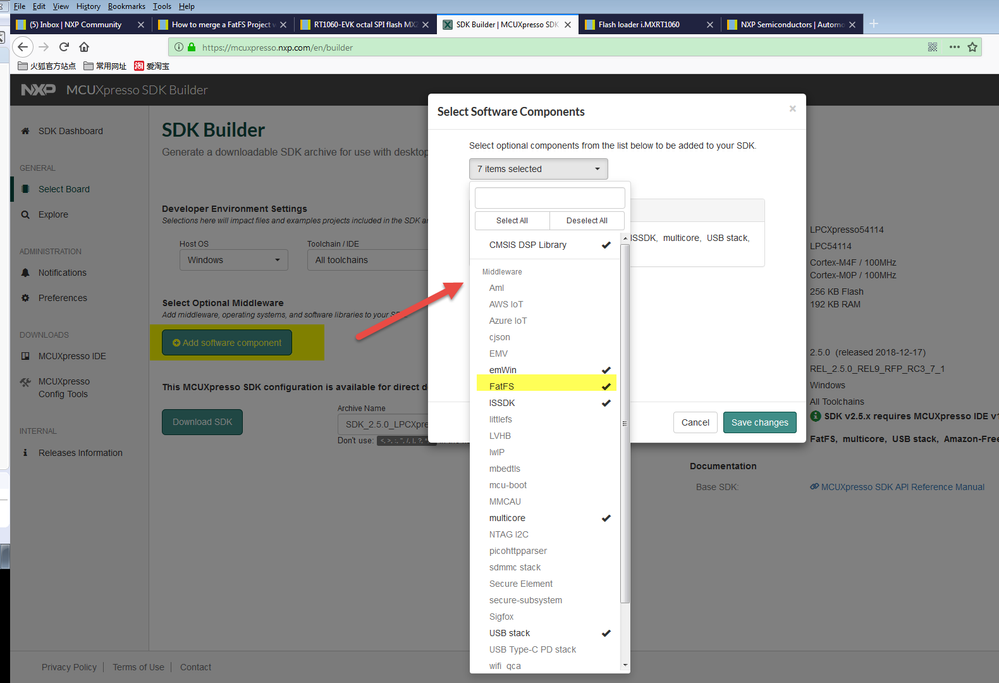

    3. midlleware dropdown my FatFS option does not appear.
     When you generate the SDK code, you need to select the fatfs, otherwise, your SDK don't have it.
Please generate the SDK again.

3 - I'm a little confused about the SDK that I built (earlier). I included 'FatFS' and a few other items as options. When I look in the lower right corner of the MCUXpresso main panel I see 'SDK Details', 'Selected SDK Content'. However, when I then start a new project and look in the 'middleware' dropdown my FatFS option does not appear.

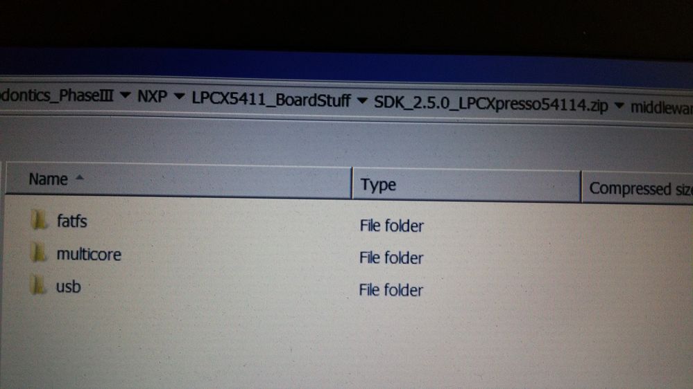

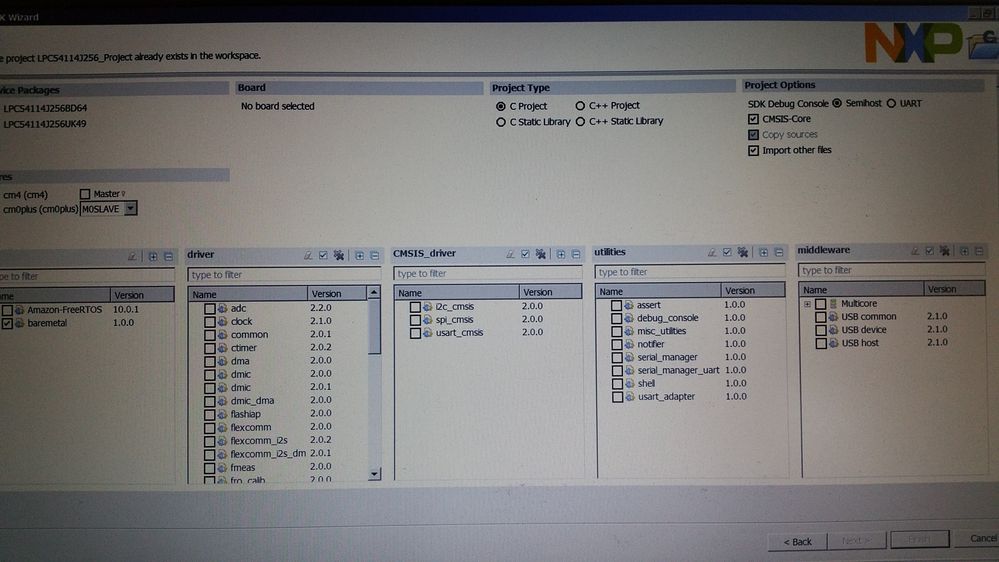

When I generated the SDK I *did* include FatFS. The situation is this - when I look in the actual SDK folder in the Windows file system I can see all of the middleware that I added when building the SDK - Amazon-FreeRTOS Kernel, FatFS, multicore, USB stack. The 'problem' is when I start 'New Project' then get to the 'Configure the Project' panel; the FatFS component *does not* appear under 'Middleware'. The RTOS and USB components *do* appear. I have attached two (2) images. I will try all that you mention.
Thanks, again,

     Yes, in the create the new project, the middleware don't have the fatfs item, but I think it is not very important, you totally can import the according file in the project after you create it.
    You can try it on your side.

I wanted to re-check the details of the comments that I sent to you yesterday. When I originally built the SDK with optional components awhile back I included 'FatFS', .... So, today I went back to MCUXpresso 'New Project', filled in 'Board Type' (processor), ....
What I was describing yesterday is that I *do not* see FatFS as an option under 'Middleware'. However, if I look 'SDK Details'/'Selected SDK Content' (Main panel of MCUXpresso, lower right hand corner, *before* we start building 'New Project') I *can* see FatFS in this list, but again, does not appear in the 'Middleware' panel when putting together a new project.
