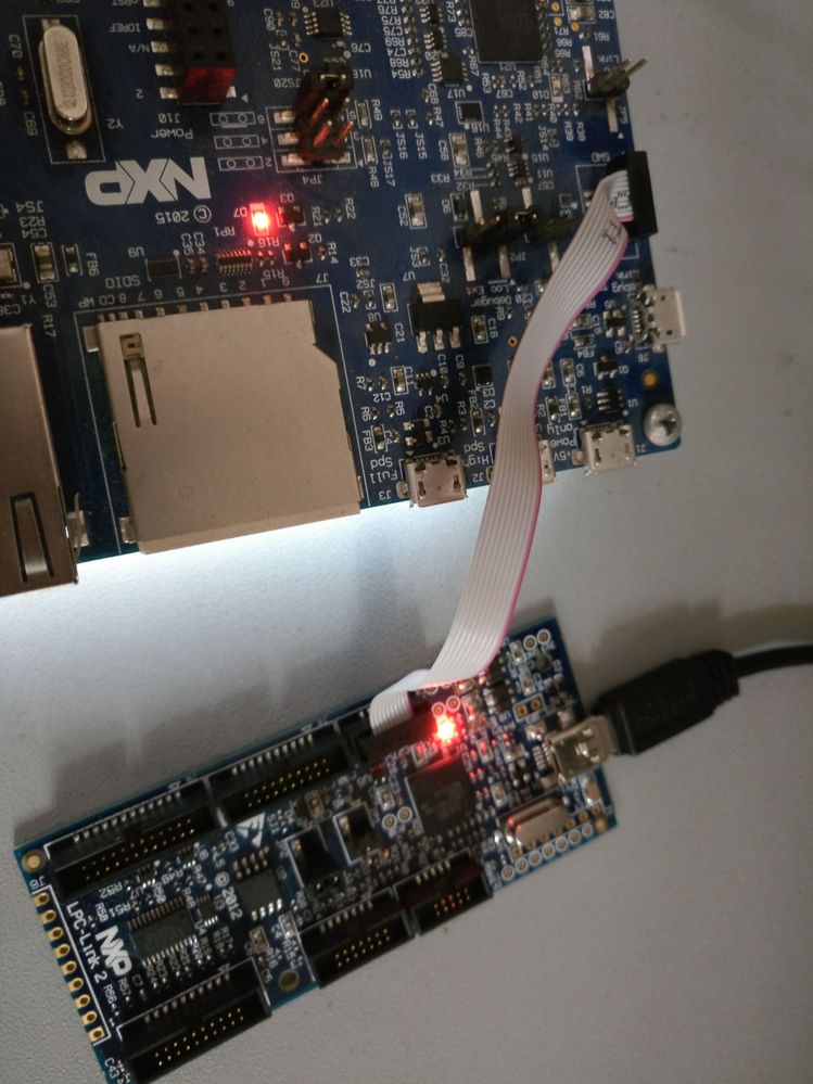

I am able to flash axf files using lpclink2 using command
         crt_emu_cm_redlink --flash-load-exec  "/lpcxpresso54s618_demo_apps_hello_world.axf" -g --debug 2  --vendor NXP -p LPC54S618J512  -ProbeHandle=1 -CoreIndex=0 --reset vectreset  -x /home/xxxxx/mcuxpresso/.mcuxpressoide_packages_support/LPC54S618J512_support  --flash-dir /home/xxxxx/mcuxpresso/.mcuxpressoide_packages_support/LPC54S618J512_support/Flash
I want to look debug console output from board lpc54608 using lpc-link2 on computer terminal.
Please let me know suggestions

Hi Subodh Mankar,
    Do you have solved your problem? I find this post is assumed answered.
    Actually, you don't need to connect the lpcxpresso54s618 console to the external LPC-LINK2, because lpcxpresso54s618 already have the on board debug, you can try the on board debugger.
  If you still have question, please let me know!

subodhmankar
Hi Kerry,
I am able to use eval-board debugger.
But when we use custom board which has only 54608/54618/54s618 then how to use lpc-link2.
In MCUXPRESSO IDE we can use in debug mode but I want to see printf outputs on console/Terminal (minicom) using lpc-link2

Hi Subodh Mankar,
    Thank you for your updated information.
    I have checked the LPC-LINK2 schematic, the on board virtual COM port didn't fan out.
   So, in your own board, I think you can find a TTL-USB tool to realize the printf function with PC.
Wish it helps you!
