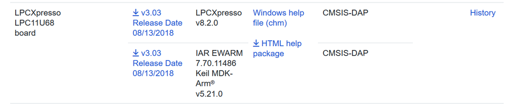

I'm new to NXP. I've purchased an OM13058 dev board using LPC11U68.
I've downloaded and opened the MCUXpresso IDE v11.2.0.
When I go to the "Install MCUXpresso SDK's" window I get a list of boards or processors chosen by a tab at the top of the selection window.
Neither the OM13058 nor the LPC11U68 are listed when I examine the lists.
When I type either identifier into the filter, the lists disappear, from which I assume that neither are listed.
Could you please explain how to proceed? With thanks.

MCUXpresso SDK only support new part of LPC , not support LPC11u68.
You can use LPCopen to development this board, download from:
LPCOpen Software for LPC11XX | NXP
Hope it helps,
