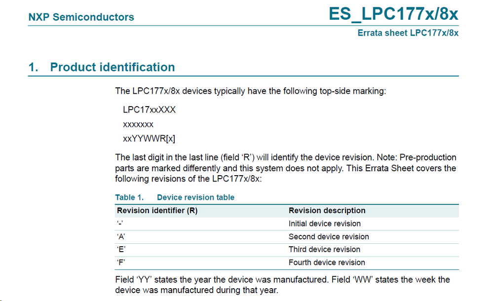

I have procured 25 numbers of LPC1788FBD208 on which the following markings are there:
LPC1788FBD208
SKP483.1
ZSD1821E

Hello jayanthy M.S. ,
Thanks for contacting our technical support, I will serve for you.
From the marking of your chip, the year of the device was manufactured is the Week 21 of 2018.
It seems this data sheet lost the Marking part, so please have a look at the Errata sheet, in Part I Product identification:
