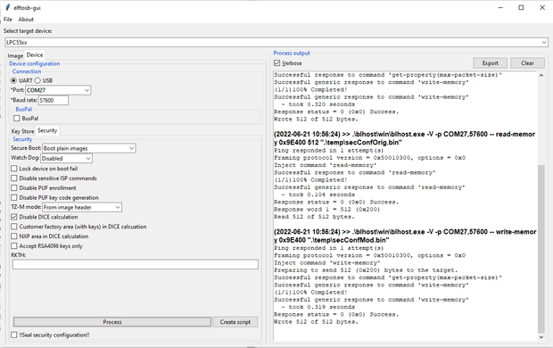

I have already brick 6 dev kit. Can you give me the way to disable secure boot and come back in unsigned mode.

Hi @Aurelien_Grange
I hope you are doing well.
You can try to set the MCU to boot plain images again using below settings on the elftosb gui. This is only in the CMPA.
However, for this we need to have ISP enabled.
All the best,
Diego.

Aurelien_Grange
I try to use MCUXpresso Secure Provisioning to come back in unsigned mode .
All command success (send empty CMPA, erase flash , and send binary) but since I can't connect with blhost, nxpdebugmbox and SWD is still not accessible.

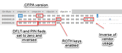

The CMPA /CFAP used looks like that :
11,290件の閲覧回数
diego_charles
Hi @Aurelien_Grange
I hope you are doing well!
I am afraid that there we do not have a  method to restore the chip's PFR ( for example ,restore CMPA and CPFA) as the chip comes from factory.
Generally speaking, if the PFR section is not sealed,  you may try to  restore several fields but there is a very high risk of bricking your part.
Are you able to show us your errors with Debug mailbox and the procedure you followed ? So we can try to determine the issue.

Aurelien_Grange
What are CFPA and CMPA to send to come back in non-secure mode?

Aurelien_Grange
The CMPA /CFAP is those i previously send
