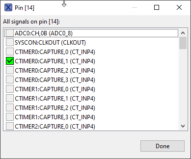

For example CT_INP4, from UM ,we can see there are two pins can configured for this function. Also in MCUXprsso Pins config, input "CT_INP4", you can see the two pins, then refer to your requirements to choose one. If choose PIO1_9, then read the status of this pin.

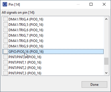

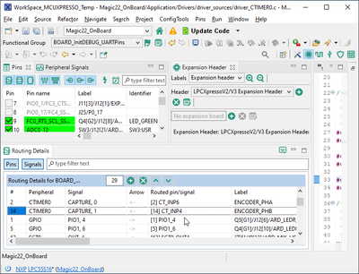

But I mean this: when an input capture is assigned I can not find any any kind of reference for (the same pin) as GPIO. As you can see the capture 1 CT_INP4 is selected as input capture.
For this pin a nane was assigned: it's ENCODER_PHB
But I don't find any reference about it. I don't know the pin number..I don't know the related port.
I solved the problem looking for some reference in the form
At the bottom of the list I found the references, but it's not very immediate. I expected to find references with witch to recall the related GPIO sdk.
Instead no.
There is any kind of solution or I have to continue with this mode ?
