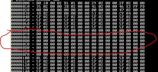

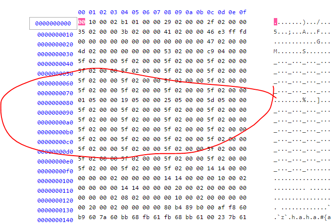

When datas are  send through UART RS485 lot of NULL characters which are not part of Datas come in between. How can we avoid unnecessary and random NULL characters coming in-between lines.
This is the required data:
But the data we are getting is :

LPC1517, and the issue has been solved because the sector contains 256 bytes, I wrote 128 bytes. so the rest was filled by NULL characters

Hi ATHMESH NANDAKUMAR,
     Please tell us what the LPC chip you are using? Please let me know the part number.
     You said, the UART send out  a lot of NULL, do you check your code, is it really sent by the LPC chip?
    If yes, then you can control your code, don't send that 0X00, this situation mainly your code problem.
