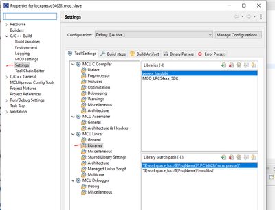

frank_m
Senior Contributor III
This is more an Eclipse thing than a MCUXpresso thing.
Right-click on the project in the "Workspace" tab, select "Properties", and add it here:
And, you can play with this settings:

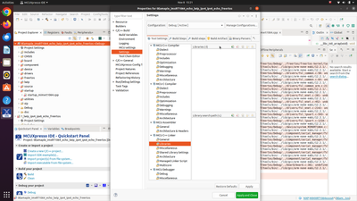

Can you explain it further - as I can't get it.Let'me explain where I'm stuck.
I've converted project into C/C++ like this and I checked MCU C++ Libraries for the include files/search paths, its completely empty as attached below img..
Also, the uploadd img is blury and hence can't understant which links to be added in Include path. Kindly, let me asap, as I'm stuck there..
