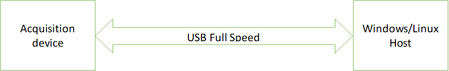

I am trying to implement a USB data bypass using OM13098: LPCXpresso54628 Development Board . The USB communication is happening as shown in the below image .

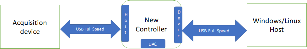

 My requirement is to implement a device to bypass the USB communication without any delay  , as shown in below image
I have implemented using beagle bone black and I feel it can be done using a controller like OM13098 .
What are your thoughts on this proposal ? It is possible using OM13098  ?

Can anyone help with any documents or a quick guide to create a Project in MCUXpresso IDE with  USB Host and Device drivers plus a FreeRTOS  . ?  As in my initial explanation my goal is to read data from host and place to device immediately . Will be playing with the data in between ,  thats why I need an RTOS also .

Unfortunately there isn't any guide to do this since this looks a little custom. But in the SDK (the 2.6 version is available now) there's a host and device examples for many clases. I don't know the device that you're using but as you mention the CDC class looks the most suitable. So I will suggest to use the following examples and try to merge it:
-LPCXpresso54628_dev_cdc_vcom_freertos
-LPCXpresso54628_host_cdc_freertos
