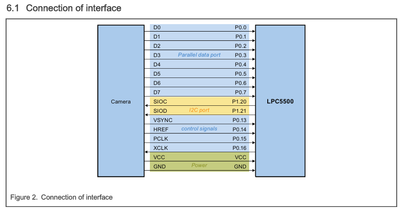

I am currently in the process of learning to use the LPCXpresso55S69 development board in conjunction with the OV7673 camera module. However, I have found that I cannot find the corresponding pins. According to the documentation in the application note AN12868 from NXP (https://www.nxp.com/docs/en/application-note/AN12868.pdf) and the open-source code on GitHub (https://github.com/nxp-appcodehub/dm-lpc55s69-multi-face-detection), OV7673 D0~D7 need to be connected to P0.0~P0.7, but I found that the P0.0~P0.6 interfaces on the development board are very scattered, such as P0.0 at P19[6], P0.6 at P20[7], but P0.7 is not found, it seems P0.7 is connected to U20[4]/SD0_CLK.
In addition, the D0~D7 wire connections in the official documentation image seem to be continuous.
If anybody could help me make better decisions it would be highly appreciated.

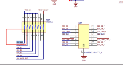

Hello @Mariposa_Marina
Thanks for your interest in NXP Semiconductors products. The LPCXpresso55s69 - evk is just a demo board, not specifically developed for this application. So the used pins are not concentrated. You can place them as you design your hardware. For this demo board, the PIO0_7 is connected to R107 - 1 as below.
