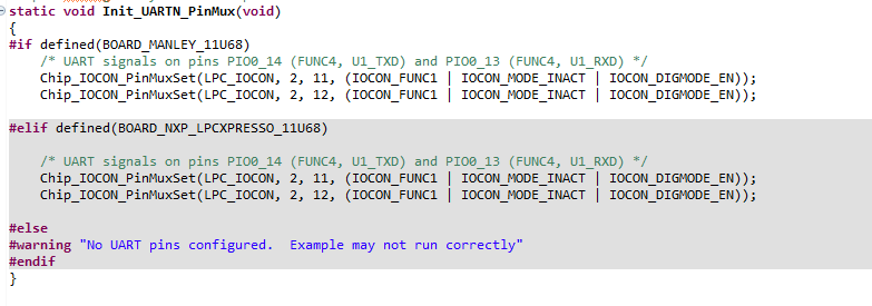

Next I edited the pin configurations for the UART4 and changed the macro to state UART4
Pin configurations:
Build and debug the periph_uart_n_rb project. Using Teraterm I verified the string.
