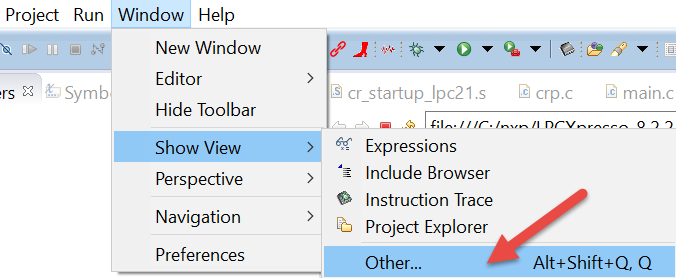

How can we view the registers used while debugging in LPCXpresso?
1,878 Views
naveen_b160496e
The board used is LPC Link2 with LPC 4370 MC. Program for HSADC was debugged. We were unable to find the registers used.

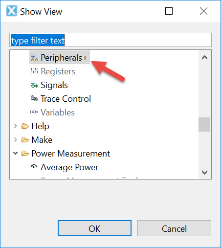

ZhangJennie
Hi Naveen,
To check peripheral registers, Please go to menu "Window", "Show View", "Other..."
double click on "Peripherals+",
To check core register,
LPCXpresso Core Registers View
Jun Zhang
