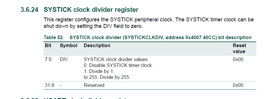

If you want the systick timer longer than 233ms, you still can divide the systick clock,

Each time when you want to change the sleep time, you just need to initialize the systick again, just redefine the systick time, then when the time is reached, enter the SysTick_Handler function, disable the systick, the sleep mode will waked up automatically.
