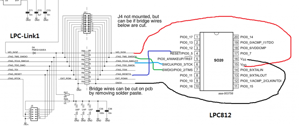

I'm trying to upload some program on LPC812 directly(no development board) using LPCXpresso.
So, I connect LPC-Link1 to LPC812 like below :
Now, I solder LPC812 on a breadboard and there is nothing wrong in the circuit.
I connect LPC-Link1 to LPC812 not only SWDIO method but also J-TAG method.
So, I connect TDO_SWOX pin to No.19 pin of LPC812 and TDIX pin to No.12 of MCU.
When I try to upload and debug in LPCXpresso, but, it can't find target(LPC812) device.
Both SWDIO method and J-TAG method failed to find target device.

Content originally posted in LPCWare by vtw.433e on Tue Feb 09 10:43:33 MST 2016
Make sure you follow the debug design in this FAQ. Provided you have followed these and provided power it should work
https://www.lpcware.com/content/faq/lpcxpresso/debug-design
Ps note that lpc810 does not have jtag. It is swd only.
