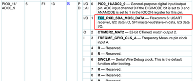

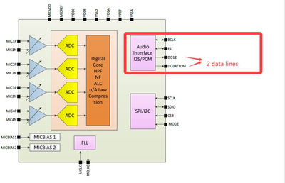

@xiangjun_rong @Thank you for your reply. DJ evaluating some quad audio Codecs which have block diagrams like the attached screenshot. Apart from TDM mode as you mentioned, customer would use the two data lines(DO12,DO34) to transfer 4-channel audio data.
  Customer is wondering if it is OK to use the following PIOs in Flexcomm6 to connect the four signals mentioned above?

Regarding your question, I have to say that you have to use two FC modules instead of one, because you have two data pins.
One solution is that you use independent SCK/WS/Data pins for each FC module, for example
FC5_SCK/FC5_WS/FC5_DATA to one Mic, FC6_SCK/FC6_WS/FC6_DATA to another Mic.
Another solution:
FC5_SCK/FC5_WS/FC5_DATA to one Mic. Connect FC5_SCK/FC5_WS to another Mic,FC6_DATA to another mic.
There is Chapter 36: LPC55S1x/LPC551x Sys_ctrl in UM11295.pdf, one FC module clock and frame clock can be shared with another one.
Hope it can help you
XiangJun Rong

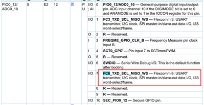

@xiangjun_rong Thank you!  DJI will try the solution 2 FC5_SCK/FC5_WS/FC5_DATA to one Mic. Connect FC5_SCK/FC5_WS to another Mic, FC6_DATA to another mic.” , because it may be a better choice to user application.
    Here is a new question:
       If the other data line is connected to FC6_DATA, can the FC6_SCK /FC6_WS  pins work as normal GPIOs?
4,026 Views
xiangjun_rong
Yes, If the other data line is connected to FC6_DATA, the FC6_SCK /FC6_WS  pins can work as normal GPIOs.
