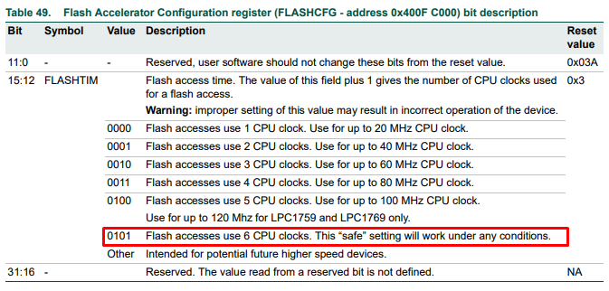

victorjimenez
Hello Ken,
Maybe FLASHTIM bit field in FLASHCFG register is marginal, make sure it's set to 5 or "safe" for all conditions.
I recommend you to take a look to the user manual https://www.nxp.com/docs/en/user-guide/UM10360.pdf  under section 5.4 you will find the following table:
Hope it helps!
