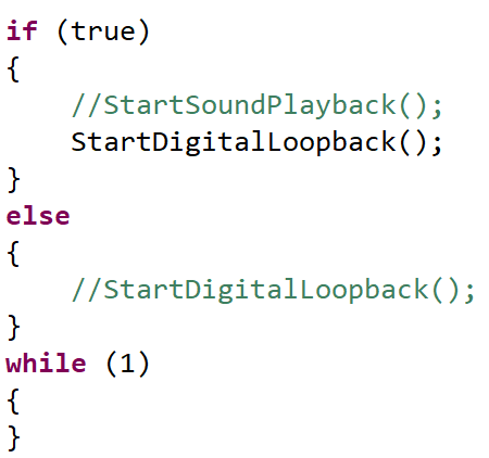

I am trying to enable an Adafruit I2S microphone (SPH0645) on my LPC54114 board. I've been trying to use the i2s_interrupt_transfer example and the usb audio device example to try and read input from the microphone but I have not been successful.
When I use an I2S audio breakout board and just plug it in the board (pins 16,18,20 on J1), audio output works, so I assumed that this would similarly work for the microphone (pins 10,12,14) but this does not appear to be the case.
I am not really editing any code, so it's more of a question of how to edit to code rather than fixing it (unless it's broken to begin with).
Any tips?
Thank you very much
N.B. the microphone works, I tested it on Arduino MKRZero.

My testings process using project i2s_interrupt_transfer is:
  1. Connect the LPC54114 board through J7 to the computer
  2. Connect UDA1334A I2S Stereo DAC breakout to pins 16 - CLK, 18 - WS, 20 - D on J1.
  3. Hear sound from the function StartSoundPlayback()
  4. Connect the I2S microphone to pins 10 - D, 12 - WS, 14 - CLK on J1
  5. Replace StartSoundPlayback() with StartDigitalLoopback()
  6. Can't hear anything
  7. I try to reconnect the microphone to pins 10 - D, 12 - WS on J1, 9 - CLK on J2
  8. Can't hear anything
I also added PRINTF statements to TxCallback and RxCallback in i2s_interrupt_transfer.c. TxCallback PRINTF executes many times, RxCallback PRINTF never executes.
I hope this helps,
Jan
