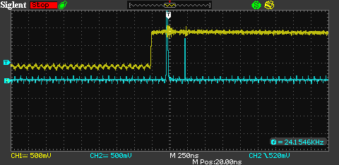

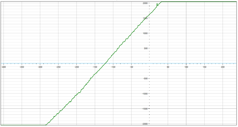

vitaliylivnov
Hi, xiangjun.rong‌
Thanks for your reply. By synchronization, I mean a trigger on the edge of the signal, as in an oscilloscope (see attached picture). I call it synchronization so that there is no confusion with the start trigger of HSADC.
In the chart above, the trigger is set to the position x = 0, y = 0, and if there were no delay the signal would cross this point. However, the signal crossed the point x = -120, y = 0, respectively, we have a delay of 120 samples of HSADC.
I’ll try to explain the problem with an example.
We set up the HSADC threshold level as follows:
/* Set low A threshold to 50% and high A threshold to 50% */
#define TRIGGER_LEVEL_DEF (HSADC_MAX_SAMPLEVAL / 2)
Chip_HSADC_SetThrLowValue(LPC_ADCHS, 0, TRIGGER_LEVEL_DEF);
Chip_HSADC_SetThrHighValue(LPC_ADCHS, 0, TRIGGER_LEVEL_DEF);‍‍‍‍
/* Setup HSADC threshold interrupts on group 1 */
/* Input 0 upward threshold crossing detect */
Chip_HSADC_EnableInts(LPC_ADCHS, 1, (HSADC_INT1_THCMP_UCROSS(0)));‍‍‍‍‍‍‍‍‍‍‍‍‍‍
In the HSADC interrupt handler, we simply switch the debug output of the microcontroller:
__RAM_FUNC void ADCHS_IRQHandler(void)
 /* Toggle debug pin */
 LPC_GPIO_PORT->B[3][7] = 1;
 LPC_GPIO_PORT->B[3][7] = 0;
 /* Get threshold interrupt status on group 1 */
 uint32_t status = Chip_HSADC_GetIntStatus(LPC_ADCHS, 1) & Chip_HSADC_GetEnabledInts(LPC_ADCHS, 1);
 /* Clear threshold interrupts statuses */
 Chip_HSADC_ClearIntStatus(LPC_ADCHS, 1, status);
We connected the first channel (yellow beam) of the external oscilloscope to the input of the HSADC, and the second channel (blue beam) to the debug output of the microcontroller. You can see in the figure below a delay of about 1.5 μs between the crossing of the threshold level of the HSADC and the triggering of the interrupt.
P.S. During the check, we noticed that when we turn on code optimization (O3), the delay decreases to 250 ns (see the picture below), but this is also a lot and the code works with errors.
9,960 Views

vitaliylivnov
Hi, a_bet‌, xiangjun.rong‌
Thanks for yor answers. I apologize for forgetting to attach a screenshot, I attach it to the post above.
Also, I apparently incorrectly described the principle of our software. This is not an interrupt from the trigger that triggers the HSADC, but an interrupt that fires when the signal crosses the threshold level (THCMP_UCROSS0). I fixed this in the description of the question. We do not stop the HSADC before the synchronization is triggered or immediately after the synchronization, but only modify the DMA LLI descriptors in the HSADC threshold ISR handler. That is, our software is an oscilloscope functional with synchronization on the leading edge of the signal. And as you can see from the screenshot above, the synchronization is delayed by about 120 samples at an ADC frequency of 80 MHz.
