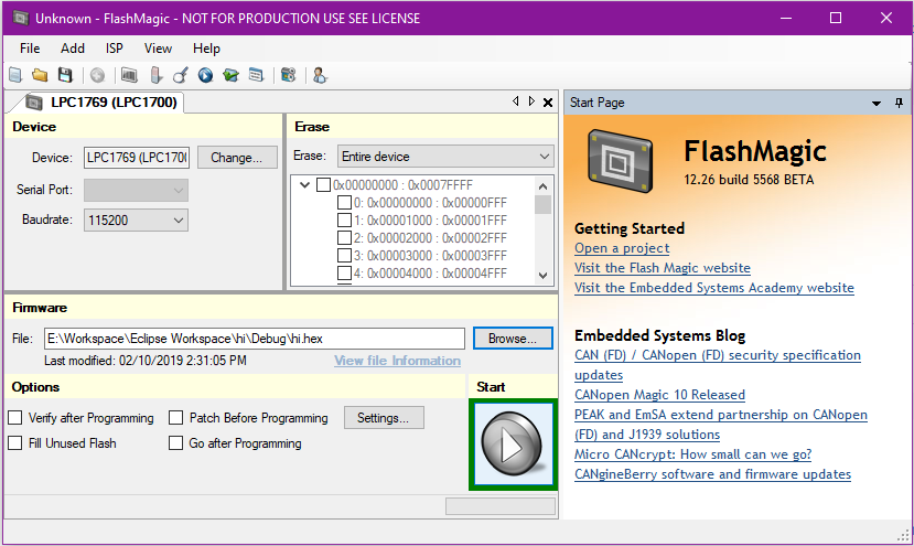

Hello I select the hex file created and the device as shown below. (Note:In the screenshot , serial port is not selected because i have not connect the the target and my laptop) When connected i select the port and then click on start button.The program gets flashed but doesn't work. I am using USB to TTL for flashing.

Have you set the vector checksum?
https://community.nxp.com/thread/389046
The vector checksum is REQUIRED to be correct for your application to start. It is described in the LPC17xx User Manual.

Hello @Con Verse ,
Thanks for your reply ,I had tried this project earlier also in eclipse itself,  at that time it was working perfectly without any errors, the GPIO got toggled. At that time i didn't set vector checksum still it was working. I don't  understand if i am doing the same thing again in eclipse , it should work.

Hello Vishakha,
Could you compare the hex files to see if there is something different between what is Keil generating against the hex file that Eclipse generates?

vishakhadakhane
Hello @Felipe García , Thanks for your reply. Now I am working on MCUxpresso. I am able to do the same project in mcuxpresso. In MCUxpresso you just need to do settings for hex files and it works. Still couldn't find the solution for eclipse. I searched but couldn't find hex settings for Eclipse. Anyways, I have decided to use MCUxpresso now.
