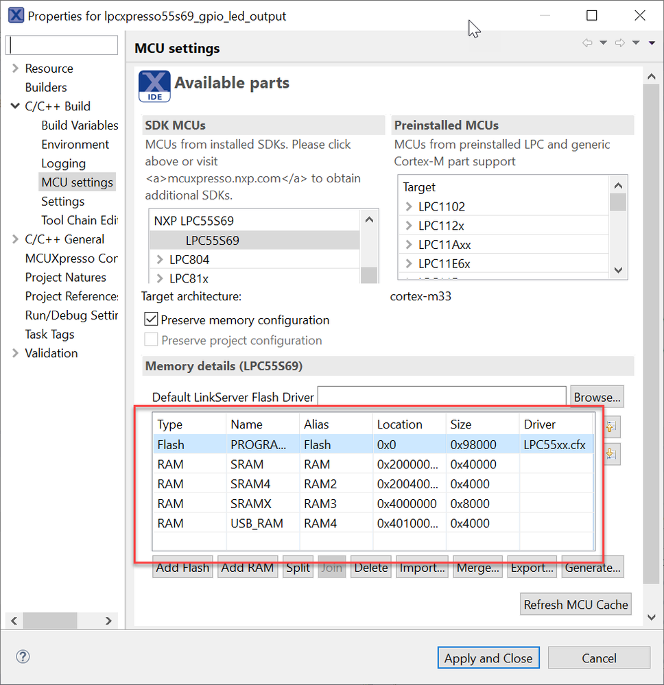

Alexis_A
Hello [email protected]‌,
If you use the same SDK from the LPC55s69 for the LPC55s66 is basically the same, you only would need to modify the RAM and Flash memory regions to match the ones for the LPC55s66:
You should be able to use the same USB examples if you modify the memory map. I find strange that the printf doesn't work and if you're using the same configurations as the examples and the LPCXpresso board this should work normally, have you try to check the communication with an analyzer or an oscilloscope the see the USART signal?

mditto1
Thank you, I was able to modify the memory map in the example project and run it on our board.  The memory config editor wouldn't let me modify the flash size, I had to edit the .cproject file and restart the IDE, but then it worked.
This lets me make some progress testing our board.  I'll ask further questions in my https://community.nxp.com/thread/531443 thread.
