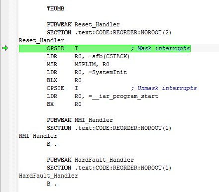

The issue is that, when I download and debug the application using the onboard debugger, MCU cannot run to main and it is stuck on hardfault. I removed "run to main" tick in order to see where it fails.
It starts with the reset handler normally.
When I click on step into it directly goes to hardfault handler.

Sat May 02, 2020 11:53:59: HardFault exception.
Sat May 02, 2020 11:53:59: The processor has escalated a configurable-priority exception to HardFault.
Sat May 02, 2020 11:53:59: Exception occured at PC = 0xffffffff, LR = 0x0
Sat May 02, 2020 11:53:59: See the call stack for more information.

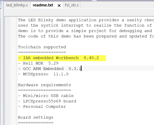

Hello Burak ,
Refer to readme, these demo support  IAR v8.40.2, I also test on IAR v8.40.2,
it can work well.
I have the same issue with you when use IAR v8.50.1.
So please use IAR v8.40.2.
TIC
