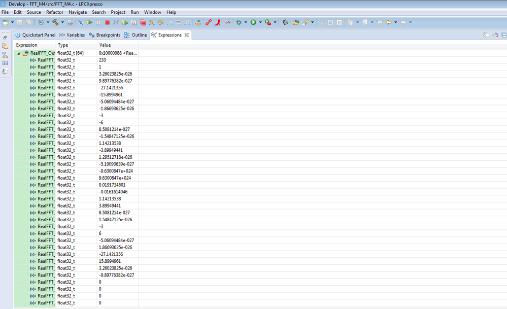

Only first vlues 233 and 1 is proper rest all are wrong. Which is correct when i checked with keils DSP library for LPC4367 M4 Core.
I have attached code for your reference. I think there might me some changes required in the DSP library imported with
LPC Expresso.
Please check the same then i think my problem is solved since with thw wrong output the timing is aroung 20uS.
Request you to please check the code in expresso.

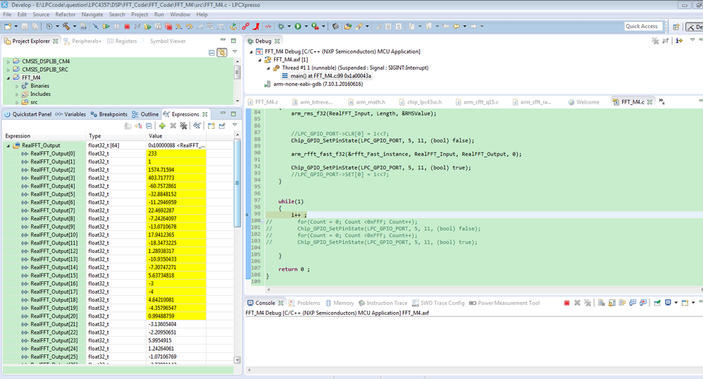

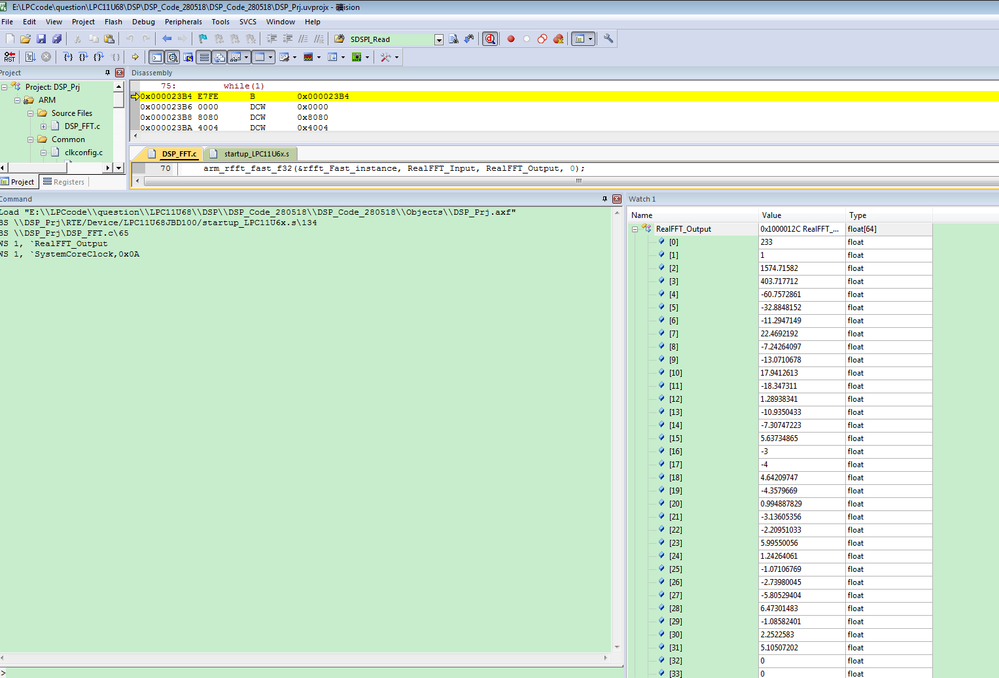

   Now, I test your according code, and do a testing summarize:
    I have tested your MDK LPC4367 DSP code on my LPCXpresso LPC43S67 board, I can debug it with CMSIS DAP, the result is:
You can find I can debug it with the CMSIS DAP debugger. I didn't meet any debug problem, so I think you can use our official lpc43s67 lpcxpresso board to test it.
This is the LPC11U68 KEIL DSP project result:
I find these two chip result with KEIL DSP lib is the same, does these data are the correct data which you want?
This is the LPC43S67 DSP code with your LPCXpresso project result:
   Just as you said, yes, this project result is really not the same as the lpc11u68 and lpc4367 mdk dsp lib project.
So, please confirm again, the newest updated question is:
1. LPCXpresso DSP lib have problems in both lpc11u68 and lpc4367
   LPC11U68 enter hardfault, lpc4367 can't get the correct Rfft result.
2. MDK DSP lib can get the correct result with both lpc11u68 and lpc4367
  But you are very care about the execution speed, the LPC11U68 is very slow, but the LPC4367 MDK dsp project can meet your demand.
  Now, actually, the LPC4367 MDK DSP function already works on your side, but you need the MDK(keil) project about the multcore for the LPC43S67, is it correct?
If yes, please refer to our lpcopen code for lpc43xx mdk project, which can be downloaded from this link, I think you can add the MDK DSP lib to the official project.
https://www.nxp.com/downloads/en/libraries/lpcopen_3_02_keil_iar_xpresso4337.zip

The hard fault handler issue is resolved in LPC Expresso library but output is not proper as ou know. Kindly let me know how can I get the help from the support team regarding the DSP library issue for LPC4367  in LPC Expresso.
Also send the latest library modified and issue resolved one so that I can add it in ny LPC expresso project.

   You said: The problem regarding the debug of code or project in keil with DAP is that every time i have to wake upt the debug controller in order to detect in the keil editor.   Could you give me more details about it? Because I debug it, I didn't find the debug problem. Please give me some picture about the keil debug problem.
   Yes, about the LPCXpresso DSP problem, actually, after I contact with our LPCXpress engineer from internal email, he already reply you in this post, now, we just need to @ him.
Hi,   lpcxpresso_support‌
     We need the help about the LPC43XX DSP LIB LPCXpresso support, please check my summarize in Jun 19, 2018 8:39 PM.
   You can find, when we use the MDK newest DSP lib with MDK IDE, the Rfft is correct, but when use the LPCXpresso install path's DSP lib, now, we don't have the hardfault, but have the result correct problem, could you help to check it? Or can you tell us, how to import the newest DSP lib to LPCXpressso IDE without problem?

      Sorry for our later response, I also didn't get the reply in the last days, but don't worry now, I also make it works on my side.
     Please check my test result:
You can find the the output data is the same as the MDK now.
Now, let me tell you the details, I downloaded the newest DSP lib from ARM, the source code is:
https://github.com/ARM-software/CMSIS_5/archive/5.3.0.zip
Then, I replace FFT_Code\CMSIS_DSPLIB_SRC\src\dspcode with the newest function code, and change the inc, inc_cmsis files with the new dsp lib, but I still didn't modify the LIB file, because we call the dsp source code directly, then it works correct now. If you want to use the lib, you also can use the newest ARM .lib.
Just as LPCX presso support said in the last post: DSP lib under LPCXpress IDE is very old, we can use the newest lib directly instead of the old DSP lib.
Anyway, I attach my project, and test it on your LPC4367 and check the result.
