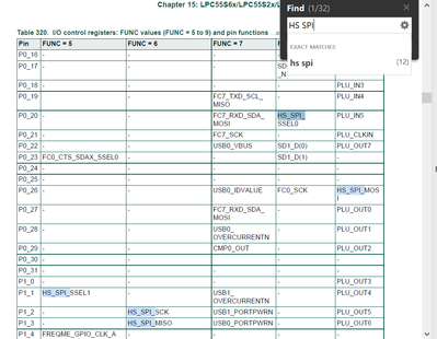

Regarding the HS SPI module, unfortunately, there is not dedicated chapter to describes it, because the HS SPI registers are the same as that the general SPI, for example for LPC55S69, pls refer to chapter
Chapter 35: LPC55S6x/LPC55S2x/LPC552x Serial Peripheral Interfaces
For the HS SPI interface, the only difference from the other FlexComm interface is that the HS SPI module is a dedicated SPI module which is not multiplexed with the other serial interface such as usart, I2C…, so you do not need to set up the Peripheral Select and Flexcomm Interface ID register (PSELID), which is required if you configure the FlexComm module as SPI function.
For the HS SPI pin assignment, pls refer to  Chapter 15: LPC55S6x/LPC55S2x/LPC552x I/O Pin Configuration (IOCON) and search the key words as “HS SPI”, you can get the pins of HS SPI.
For LPC55S69, you can get as the following Fig.
Hope it can help you
XiangJun Rong
