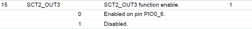

I'm getting the interrupt for Event[0] but it seems that OUT[3] is not toggling. I can't look at OUT[3], the SWM only allows SCT2_OUT[0-2] to go to pins, and the ADC only allows SCT2_OUT[3-4] to trigger, so I set up OUT[0] to operate in the same way and I don't get an output for OUT[0].
I'm obviously missing something, if any one can help me out I would appreciate it.

jeremyzhou
Hi Greg Wilson-Lindberg,
Thanks for your reply.
After have a brief of review, I don't find any obvious errors.
So I'd highly recommend you to assign the SCT2_OUT3 to PIO0_6, then you can display the SCT2_OUT3 in OSC.
It's helpful to figure out the root cause of the issue.
TIC
