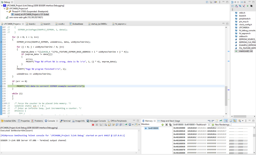

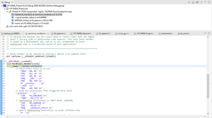

I'm testing internal EEPROM of LPC54606 in which I want to write 64 bytes using EEPROM_Write() function. But after calling this function controller goes in Hardfault handler and then not able to write data into EEPROM.
I have referred lpcxpresso54628_eeprom example project.
I'm attaching my test project for reference.

rjleiser
I have the exact same problem. I am also using a 54606.
If I single step the interal code for EEPROM_Write() then it works.
If you just normally run EEPROM_Write() then I get a hardfault.
So it must be an underlying timing issue.
The short answer (not previously given) is to use EEPROM_WriteWord(); (with multiple calls) instead.

emb02
Contributor V
Hi @xiangjun_rong
Pls try to execute the line, and check which line leads to the hardfault
-> I don't get error while debugging (step in).
But in runtime MCU goes in hardfault handler.
Not able to understand this.
