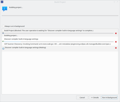

Hello
I try to build project for lpc1769 but mcuxperrso stuck in Discover compiler built-in
Can you help me?
I'm on debian and MCUXpresso IDE v11.9.1
lsb_release -a
No LSB modules are available.
Distributor ID: Debian
Description:    Debian GNU/Linux trixie/sid
Release:        n/a
Codename:       trixie
1,686 Views
simonfourquier
is a bug in eclipse on Debian testing
https://github.com/eclipse-cdt/cdt/issues/835
we can controuning it with
prlimit --nofile=3741816:1073741816 -p $(pidof mcuxpressoide)
