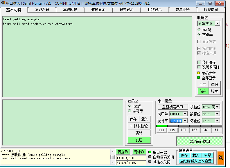

kerryzhou
Hi arecz,
    Your problem is mainly caused by the code, I have tested on my side, it works OK.
   I think you didn't modify this point, board.h
#define BOARD_DEBUG_UART_TYPE DEBUG_CONSOLE_DEVICE_TYPE_FLEXCOMM
#define BOARD_DEBUG_UART_BASEADDR (uint32_t) USART0
#define BOARD_DEBUG_UART_INSTANCE 0U
#define BOARD_DEBUG_UART_CLK_FREQ CLOCK_GetFreq(kCLOCK_Flexcomm0)
#define BOARD_DEBUG_UART_CLK_ATTACH kFRO12M_to_FLEXCOMM0
#define BOARD_DEBUG_UART_RST kFC0_RST_SHIFT_RSTn
#define BOARD_DEBUG_UART_CLKSRC kCLOCK_Flexcomm0
#define BOARD_UART_IRQ_HANDLER FLEXCOMM0_IRQHandler
#define BOARD_UART_IRQ FLEXCOMM0_IRQn
#define BOARD_DEBUG_UART_BASEADDR (uint32_t) USART4
#define BOARD_DEBUG_UART_INSTANCE 4U
#define BOARD_DEBUG_UART_CLK_FREQ CLOCK_GetFreq(kCLOCK_Flexcomm4)
#define BOARD_DEBUG_UART_CLK_ATTACH kFRO12M_to_FLEXCOMM4
#define BOARD_DEBUG_UART_CLKSRC kCLOCK_Flexcomm4
#define BOARD_UART_IRQ_HANDLER FLEXCOMM4_IRQHandler
#define BOARD_UART_IRQ FLEXCOMM4_IRQn‍‍‍‍‍‍‍‍‍‍‍‍‍‍‍‍‍‍‍‍‍‍‍‍‍‍‍‍‍‍‍‍‍‍‍‍‍‍‍‍‍‍‍‍‍‍‍‍‍‍‍‍‍‍‍‍‍‍‍‍
After the modification, the printf information:
Please note, J13_13 is P3_27-FC4_TXD, you need to connect it to USB-TTL RXD.
  J13_15 is P3_26-FC4_RXD, you need to connect it to USB-TTL TXD.
Wish it helps you!
Kerry

kerryzhou
Hi arez,
    Do you have any other TTL-USB tool?
    I think it is related to your TTL-USB tool, it is the 3.3V or the 5V in TX and RX?
   Actually, even you didn't add the TTL-USB tool, when you test the mcu UART TX pin()J13_13, the UART send out data wave is very clean.
   Please check my test result for J13_13 without the TTL-USB tool:
You can test it on your side.
I suggest you find a ttl-usb tool which can support 3.3V signal.
As you know, LPC54628 is the 3.3V mcu.
Wish it helps you!
Kerry

arecz
Hi Kerry,
So I had checked signal with a good scope. All signals were fine. So I decided to change my USB tool. I just receive it and try with it. The NXP demo are working well now.
Thank you for your support.
9,820 Views
