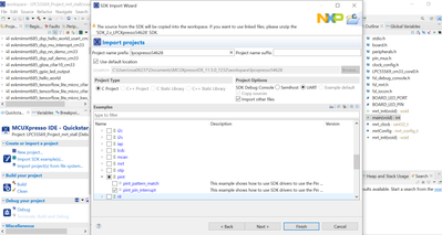

Hey all,
is there any example code for external interrupt (falling edge) in LPC54606J512BD100 micro-controller.
If any one have the reference then please let me know, i tried but did not found the example code for this.
@nxp @xiangjun_rong @nxp_敢爷
ラベル(6)
5 返答(返信)
4,300件の閲覧回数
xiangjun_rong
Yes, there is PINT example, which is loicated in driver_example->PINT->pint_pin_interrupt as the following screenshot.
Hope it can help you
