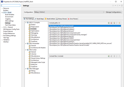

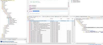

Hello Team,
I am trying to build FreeRTOS module using MCUXpresso IDE, but the build is failing.
All the respective header files exist in the stack. The header file path is set in the includes.
"portmacrocommon.h" is already present in this path "freertos\freertos-kernel\portable\GCC\ARM_CM33_NTZ\non_secure"
Please find the snapshots below for your reference.
Can someone please let us know, what is still missing?

sushmasan
Finally, I was able to compile the FreeRTOS component.

Hi @sushmasan
Sometimes, using relative paths can cause issues. As a test, try adding the absolute path to the non_secure folder containing portmacrocommon.h directly in your project settings to rule out any issues with relative paths.
If your problem has not been resolved, can you share your project?

Harry_Zhang
Hi @sushmasan
I import your project into my MCUXpresso IDE, and i haven't made any changes,
I compiled without any errors.
So I suggest you delete this workspace and create a new one.

andrewsglenn
What happens if you set the path in the Includes tab of "Properties->C/C++ General->Paths and Symbols" ?
3,707 Views
sushmasan
Even after setting the path in this location, still there is no change in the behavior, I am getting the same error.
