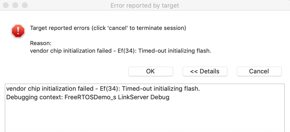

Not sure if this is the right place to ask.
But when following the following example:
https://www.freertos.org/RTOS-Cortex-M33-LPC55S69-MCUXpresso-GCC.html
I can execute all the steps okay (I think). But only the last step not I get the following error screens:
ef(34): Timed-out initializing flash. See the attached screen shot. Does somebody know what goes wrong?
Thanks!
 Jasper
Labels (2)
4,684 Views
jasper1
Finally solved the debug problem :smileyhappy:
I could solve the debug-problem through setting Debugger -> Configuration Options -> Flash Driver Reset Handling -> Select SYSRESETREQ in the launch configuration of the project (of the FreeRTOSDemo_s project).
(saw this via the thread: https://community.nxp.com/thread/500210)
 Jasper

Sebastian_Del_Rio
Hello Jasper, I hope you're doing well!
Could you please check the examples provided in the LPCXpresso55S69's SDK?
If you added the Amazon FreeRTOS middleware component to your SDK, you should have some examples also installed that show you how to work with the OS.
Could you please try with one of these examples and see if the problem persists?
Sebastian
4,684 Views
jasper1
Hi Sebastian,
Thanks for asking. The example projects:
lpcxpresso55s69_hello_world
lpcxpresso55s69_led_blinky
They work fine, I can debug them with breakpoints and the console prints the output.
The error message in the console when try to debug:
FreeRTOSv10.2.1/FreeRTOS/Demo/CORTEX_MPU_M33F_NXP_LPC55S69_MCUXpresso/Projects/MCUXpresso/Secure/Debug/LPC55S69.xml
is:
Flash Driver V.2 startup failed - rc Ef(34): Timed-out initializing flash.
chip initialization failed - Ef(34): Timed-out initializing flash.
failed to initialize flash driver LPC55xx_S.cfx
can't find a flash driver called ''
Last line is maybe a clue to this debug problem.
Is there an other FreeRTOS LPC55S69 example which I can test?
(BTW I am able to do a mass erase of the flash in between switching the examples, without any errors).
 Jasper

jasper1
