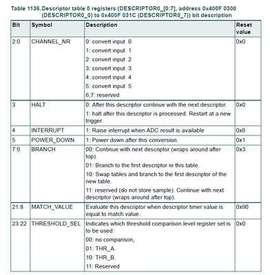

For LPC4370 HSADC, how to reduce the match time of descriptor #0 from 0x95 to 1?

For the STATIC INLINE void Chip_HSADC_SetupDescEntry(LPC_HSADC_T *pHSADC, uint8_t table,
uint8_t descNo, uint32_t desc)
pHSADC->DESCRIPTOR[table][descNo] = desc;
it writes the DESCRIPTOR0_[0] register or DESCRIPTOR0_[1] reg..., the HSADC_DESC_MATCH(x) corresponds to the MATCH_VALUE bits, if you do not want to use the timer of HSADC, just set the bits as 0 with HSADC_DESC_MATCH(0). If the MATCH_VALUE bits is zero, it means that the ADC samples the channel in the descriptor immediately.
Hope it is helpful
