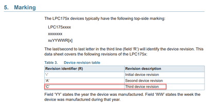

Hello NXP community,
I've recently purchased a newer version of LPC1758FBD80 (AZC39200 11 SSD2347C) to replace my older LPC1758FBD80 (SKB283.1 10 ZSD1810A).
I am encountering two issues:
  • Flashing via IAR fails with the following error :
Error while calling macro execUserFlashInit Failed to load flash loader: FlashNXPLPC512K_Cortex.flash Could not start CPU core. (ErrorCode: -2)
The same IAR setup works perfectly on my older LPC1758FBD80.
I already tried with the latest version of IAR ARM toolchain, it still fails with the same error.
  • Using J-Flash seems to correctly load my binary into the chip, but my application does not seem to run on the recent LPC1758FBD80, while the same binary works perfectly on the old one.
Questions:
  • Are there recommended updates for IAR flashloader macros or settings to support recent LPC1758FBD80 (AZC39200 11 SSD2347C) ?
  • Is there a published errata / change log for recent LPC1758FBD80 (AZC39200 11 SSD2347C) that specifies differences in boot ROM, flash, or PLL initialization?
  • Are there any known changes required for the recent LPC1758FBD80 to run applications ?
I would appreciate any guidance or recommendations on how to migrate applications from an old LPC1758FBD80 to a more recent one.
Thank you

diego_charles
Hi @Tay33
Thank you for reaching out! I understand that you are migrating from the second device revision to the third device revision.
The latest revision corrects some erratas from the previous revision. According to Table 2. Functional problems table But we do not have another errata version available that explains further the changes.
As I have been checking there is no new software released for this revision, and we do not  guidelines to update the flashloader for IAR.
You mentioned failure to boot the even after programming with J-Link. Can you check the ISP pin? What is the measured voltage of this pin when using the lastest revision?
Diego
