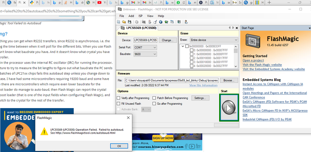

VishnuBoyapati
I am facing auto baud error with all baudrates.
4,203 Views
Open Device Manger, check whether the UART port number is right.
After connect , click ISP-> Read Signature, try more times.

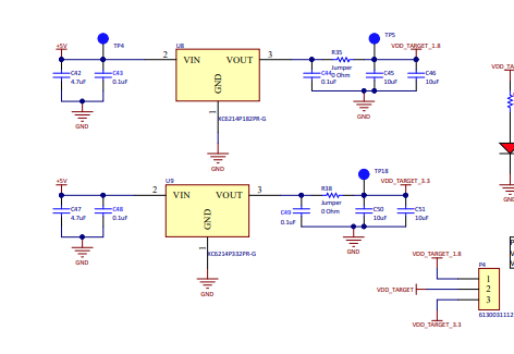

I don't have any experience using these boards but i went through the schematics and was able to see that vdd_target is high but the led isn't blinking. Therefore, the line connected to the MCU is open because somehow the configurations of MCU are corrupted and i want to check the conf files which i am unable to. Alice, can u please help me figure out what could be wrong? Screenshot 2022-02-24 003942.pngScreenshot 2022-02-24 003942.png

What do you meaning about " flash loader "? Boot ROM?
How do you know it is corrupted?  Can't connect to debug?
Does it can enter ISP mode?
