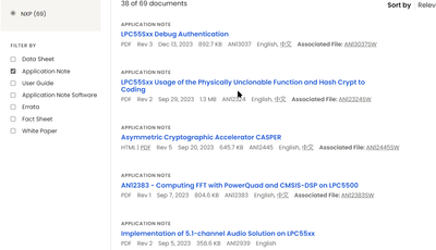

If you want to know more about this there are some apps note that could help you to setup.
Spoiler
The other way is modifying the CPMA and CFPA using the Flash API or using the tool Blhost through PC Host serial interface.
