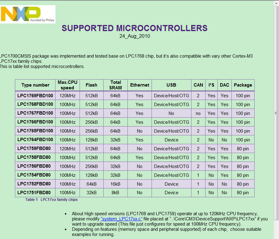

kerryzhou
Hi hossein ef,
   Please check my attached help file, this is the according LPC1700 Peripheral Driver Library Manual.
   This manual list all the function.
    I think there has some function difference between lpc1768 and lpc1788.
   This CMSIS library supported MCU is list as follows:
  Now, do you need cmsis library for LPC1788?
Kerry
