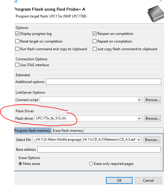

Please advise how to troubleshoot.
Also when I start the flash programming, I do not see a drive for LPC176x in the flash driver option.

ravitej_ati28
Hello Alice,
I was able to program the flash memory. It was because the axf file generated wasn't the correct one. After fixing the compilation errors, I was able to get a working axf file and was able to program with no issues.

ravitej_ati28
I tried to program it again, now I am getting this error

Et:57: ELF file has no initialized code/data: 'C:\Users\rjakati\Desktop\2I-Main-MultiLanguage_V4.1\2I-Main-MultiLanguage_V4.1\LCD_4.3\Release\LCD_4.3.axf'
Pc: (100) Target Connection Failed

Hello Ravitej Jakati,
How about download a simple project ?
And what about the whole part number of your chip.

ravitej_ati28
Hi Alice,
it's an LPC1768ADC
