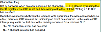

Based on the RM, there are two lines to clear a channel flag:
(void)FTM0->CONTROLS[0].CnSC; /* Read to clear flag */
FTM0->CONTROLS[0].CnSC ^= FTM_CnSC_CHF_MASK; /* Clear flag */
However, stepping through this in debug mode shows that CHF stays at 1. I've tried clearing the flag using the STATUS register to no avail.

And pay attention:
"If another event occurs between the read and write operations, the write operation has no
effect; therefore, CHF remains set indicating an event has occurred."

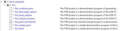

Hello @rmaier
There is a demo about two channel under SDK, how about first test with it?
Does the issue can reproduce on this demo?
Alice

rmaier
Hello Alice,
I don't think any of the examples address the issue at hand. The twochannel example is regarding PWM. I am using output compare. Disabling the output compare interrupt does not immediately disable the output compare interrupt. Also, clearing the flag does not seem to actually clear the flag.
