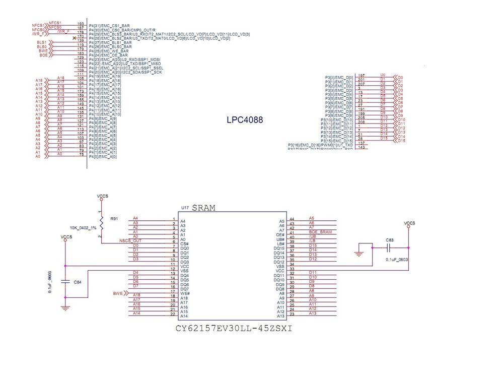

I am facing some trouble related to data handling in the external SRAM(Cypress) which is a 16-bit 1MB SRAM interfaced with LPC4088 using EMC.
I use many structures with mixed data types inside. So many times after writing to SRAM, I read garbage(improper) data. Has anyone ever came across such problem?

The SRAM configuration I used is
STATIC const IP_EMC_STATIC_CONFIG_T SRAM_config = {
 1,
 EMC_STATIC_CONFIG_MEM_WIDTH_16 |
 EMC_STATIC_CONFIG_CS_POL_ACTIVE_LOW |
 EMC_STATIC_CONFIG_BLS_HIGH /* |
             EMC_CONFIG_BUFFER_ENABLE*/,
 EMC_NANOSECOND(35),
 EMC_NANOSECOND(5),
 EMC_NANOSECOND(45),
 EMC_NANOSECOND(0),
 EMC_NANOSECOND(45),
 EMC_CLOCK(0)
I have attached the pin connection diagram as well. The only fault I see is that A0 of EMC(LPC4088) is connected to A0 of SRAM. Instead A1 of LPC4088 should be connected to A0 of SRAM.

To check that I have created a small program in which I just read & write structure in SRAM. Still unable to read correctly.

With this information I think the problem could be in the layout, please check the next application note, there's some consideration you need to have in the layout of the board.
https://www.nxp.com/docs/en/application-note/AN2582.pdf
You also could try writting a location and after that reading this multiple times and comparing if its the same information, maybe some module around the memory is causing noise.
Let me know your findings.

I read the Application note you suggested. It is related to DDR RAM while I am using SDR RAM.
The second thing you asked to tryout is the data retention test. Data read is correct even when hundreds of times I read it.
I also came across an embedded board based on Atmel IC which uses the same SRAM as I am using & the only difference between that & mine is the address shift.
In their schematic: A1 of Atmel is connected to A0 of SRAM.
In my case: A0 of LPC4088 is connected to A0 of SRAM.
I am attaching Atmel board's schematic for the reference.
So now I am trying to change this & see if that works.
