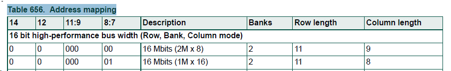

I am developing firmware on the LPC54605J256ET180. I have custom hardware with an external SDRAM chip connected to the EMC. I was hoping I could get some help configuring all the different timing registers for my RAM chip.
I am using the NXP emc driver and following the demo app used for the OM13092 LPCXpresso54608 Dev board.
RAM chip:
Winbond W9816G6JH-6
MCU Setup:
1) Using 12MHz external crystal and running core clock at 180MHz
Initialization Code:

With the code above, it passes the test routines, BUT only when I run the MCU core clock at 96MHz with BOARD_BootClockFROHF96M.
But when I run the core clock at 180MHz with BOARD_BootClockPLL180M, it fails the _______.
I increased the clock divider, but that does not seem to get it to work. I'm guessing the timing parameters are wrong. I kinda had to guess on some of them because i'm not sure how to get them from the datasheet.
Specifically the HW_SDRAM_REFRESHPERIOD_NS parameter. I'm not sure how to choose this value with the datasheet.

After you set the core clock to 180mhz, If you change the clock divider basicConfig.emcClkDiv = 3; in the case, the EMC_CLK will be 180MHz/(3+1)=45MHz, what is the result?

I think the W9816G6JH-6 has different row size with the MT48LC8M16A2B4. So the parameter #define SDRAM_REFRESHPERIOD_NS is different
assume the the clock frequency is 100MHz.
for the MT48LC8M16A2B4, the SDRAM_REFRESHPERIOD_NS  is  (64 * 1000000 / 4096) /* 4096 rows/ 64ms */
for theW9816G6JH-6, the SDRAM_REFRESHPERIOD_NS  is  (64 * 1000000 / 2048) /* 2048 rows/ 64ms */
Pls have a try
XiangJun Rong
4,462 Views
xiangjun_rong
The W9816G6JH is 512K*2Bank*16 bits SDRAM, it is 1M*16 bits, based on the Table 656. Address mapping, so the parameter
#define SDRAM_DEV_MEMORYMAP (0x01u) /* 16Mbits (1M*16, 2banks, 11rows, 8 columns)*/
Pls have a try
XiangJun Rong
4,462 Views
guitardenver
XiangJun Rong,
Thanks for the reply.
What is the difference between the "high-performance bus width" and just "16 bit bus width"?
4,463 Views
xiangjun_rong
Hi, Matt,
Generally speaking, the "high-performance bus width" mode can generate low latency timing to access the SDRAM, but we have not detailed description to clarify the feature and highlight the difference between two modes. I am sorry.
After the modification, can you access the W9816 correctly?
Xiangjun Rong
4,462 Views
guitardenver
Yes, that was the fix. Although I needed to use the "16 bit bus", not the high performance one. Does not work on high performance. Too bad there is not any details of what the difference is.
Another parts of code was overwriting it to use the high performance. I have it like this now and it seems to pass all tests. Thank you for your help.
#define HW_SDRAM_DEV_MEMORYMAP (0x21u) // 16Mbits (1M*16, 2banks, 11 rows, 8 columns)
