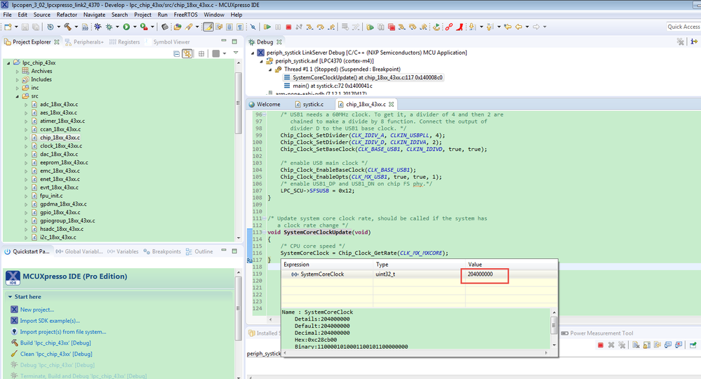

Dear Sir,
Is there code example of how to set the Base_M4_Clock to 204Mhz ?  from the power on default 96MHz .
I have read through se. 13.2 of LPC4370 user manual, and understand the procedures, but I would very appreciate to have a working code example that I can learn from.
タグ(2)
1 返信
1,191件の閲覧回数
kerryzhou
Hi CP chen,
   Please refer to our LPCopen code, I have test the LPC4370 lpcopen code, that project already configure the clock to 204Mhz, this is the test result:
You can find the lpcopen code from this link:
LPCOpen Software for LPC43XX|NXP
Kerry
