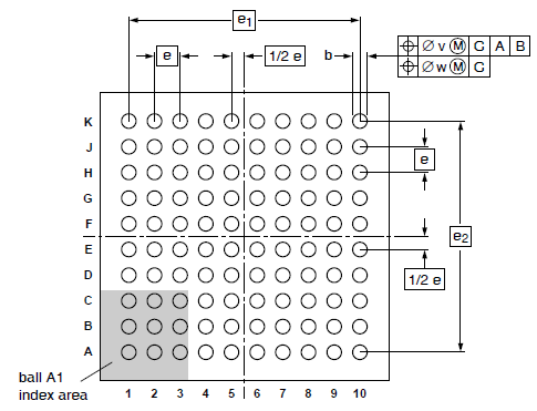

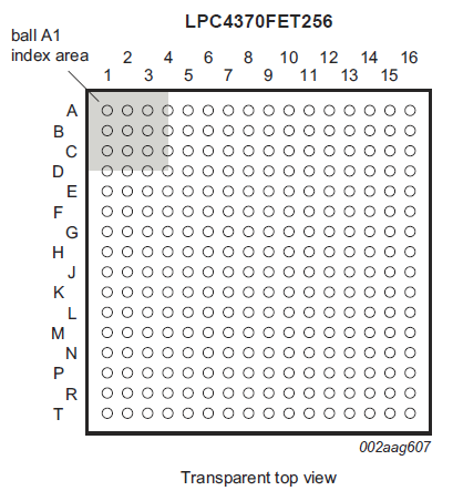

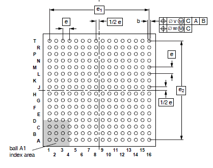

The package layouts for LPC4370FET100 and LPC4370FET256 should be

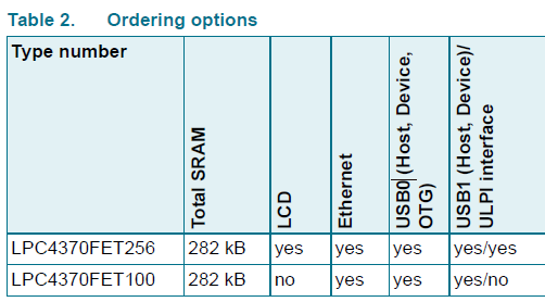

However, the datasheet for LPC4370 (Rev 2.3 - 15 March 2016) shows

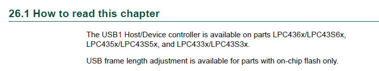

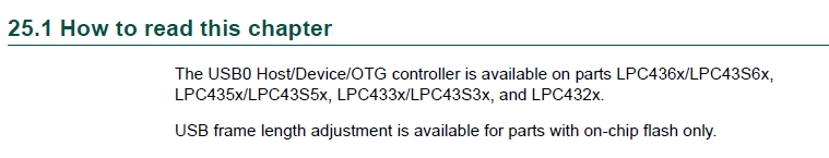

User manual for LPC43xx/LPC43Sxx shows
However the LPC4370 datasheet shows
In other words, LPC4370 and LPC43S70 should have USB0 and USB1.

1. Ball A1 index area should locates in the upper left corner.
2. Yes, the USB modes are contained in the LPC4370.
