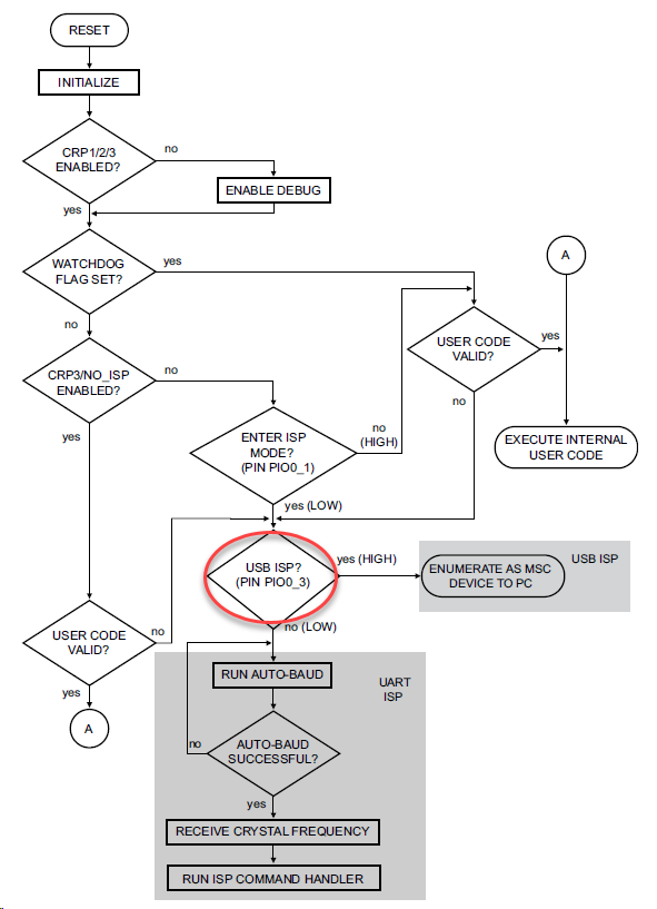

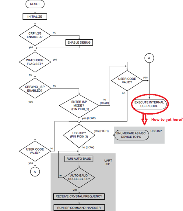

I'm using LPC11U68JBD48 microprocessor. I have a switch which toggles PIO0_1 pin. I can go into the ISP mode by pressing the switch and by applying power to the board (Resetting board).
Now I have my application code running and I would like to create a means to invoke the ISP USB MSD over my application so the toggle switch is not necessary. What I would like to do is that when I get a command from PC application by USB protocol, I would like my application (LP11U68) go into the SPI mode.
Is it possible with LPC11U68JBD48 microprocessor?
I'm using Chip_IAP_ReinvokeISP() function to make my application to go into the ISP USB mode.
What I have noticed so far:
1. If I call Chip_IAP_ReinvokeISP() very early in main function, it DOES go into the ISP mode, but if I put any delay (say 1 second), it doesn't go into the ISP mode.
2. When I set GPIO initialisation as below and call Chip_IAP_ReinvokeISP(), it does not go into the ISP mode.

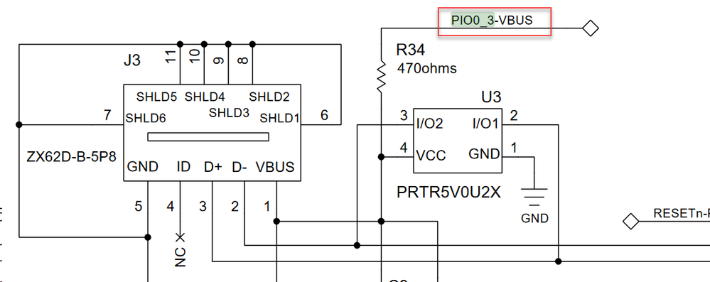

LPC_IOCON->PIO0[3] |= (1 << 0); /*set up of PIO0_3 register to USB_VBUS*/
LPC_IOCON->PIO0[3] |= (0 << 3); /*and inactive pull-up/pull-down resistors*/

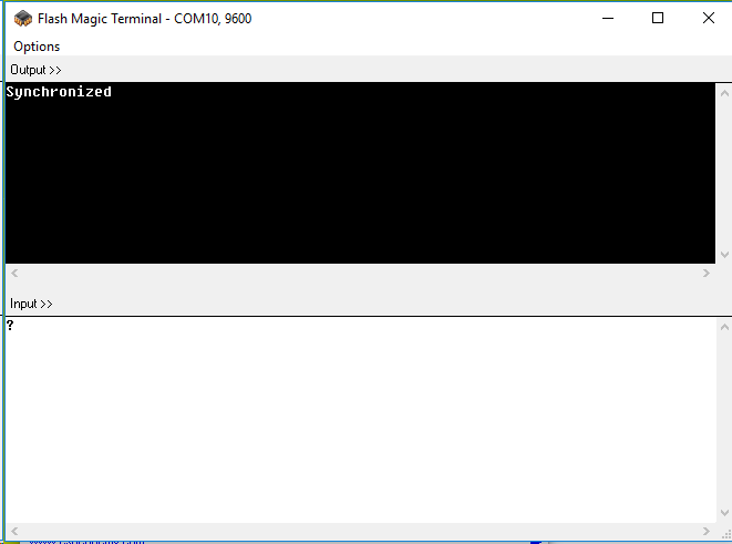

Thanks Ricardo for your reply.
Your code above doesn't seem to be working for both LPC11U68 development board and my board in which there is a LPC11U68 chip. I checked whether it appeared as a Mass Storage Class (MSC) device or not.
See an example picture below which shows I could go into the ISP mode by pressing the switch(PIO0_1 pin) and by applying power to the board (Resetting the board). The idea is that my PC application would access CRP DISABLD (E:) drive and replace it with a newer firmware. This way, we could update the firmware in the field. Our product won't have any button, that's why I would like to go into the ISP mode at the runtime when I get a command from the PC application.
Do you have any other suggestion for the field firmware update?
Can you update the firmware by using Tera Term or Flash Magic?

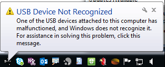

When I ran your code, it appeared as follows instead of the picture above.
My code below seems to be working if I comment out the line, LPC_IOCON->PIO0[3] &= (1 << 0);.
However, with LPC11U68 development board it seems to be working no matter that I comment out that line or not.

    It does seem to be working but with my board it seems to go into the ISP mode only if there is delay less than 600ms at the start up. If I add some delay (3 seconds) and then call Chip_IAP_ReinvokeISP() this function, it does not work.
  2. Do I need a USB-RS232 cable in order to use Flash Magic? If so, this won’t be feasible as our customer won’t have this cable. This is why we are developing a PC application which could send a usb command to the LPC microcontroller, then the LPC micro could go into the ISP mode at runtime. Would this be possible?
  3. I also checked my code with the LPC11U68 evaluation board (OM13058), and it seems to be working fine. Could you please check that CRP DISABLD drive can appear in a PC when you go into the ISP mode rather checking with Flash Magic?
  4. I understand that it would be difficult to examine my problem as you don’t have my board and schematic but could you think of anything why my board it seems to go into the ISP mode if there is delay less than 600ms at the start up, but not with the delay (3 seconds)
  5. Could you possibly give me a quick guideline how to use Flash Magic as I haven’t used this before? Would this be useful to debug the ISP mode?

1. It is possible to enter ISP mode during run time. In order for the computer to recognize the board as a MSC device, pin P0_3 must be high when calling Reinvoke ISP just like it shows in the following booting flow chart:
2. If you want to use USB ISP then you don't need to use Flash Magic and neither a USB-RS232 cable. When you are in USB ISP mode you can easily drag and drop your new firmware to the MSC device in your PC. Please consider that when using USB ISP, the user code valid signature must be either part of the vector table, or the axf (or binary) file must be post-processed to insert the checksum.
Regarding your second question from this point, it's possible, but your application in the MCU will need to recognize this command in order to call the function Re-Invoke ISP.
3. Thank you so much for clarifying this. I've already checked on my side, and when I call Reinvoke ISP and have P0_3 high I'm able to see the LPC as a MSC device (CRP DISABLD).
4. The delays shouldn't affect the ISP mode at all. You have to keep in mind that when you call the function Reinvoke ISP your pin P0_3 has to be high. For the development board OM13058, this pin is connected to VBUS on the J3 connector, so when you connect a cable to this connector this pin goes to high immediately. Please check this connection on your board.
5. Since you want to use USB_ISP, the use of Flash Magic is no longer necessary. Flash Magic is a good tool only when you want to use I2C_ISP, SPI_ISP or UART_ISP.
I hope this can answer your questions.

    My following question is that how to get USB ISP (CRP DISABLD) once the user code is running from the diagram below? Pin P0_3 seems to be checked during the boot process after the reset. What about after entering the user code?
    Also, Pin P0_3 is always high once powered. Calling Reinvoke ISP seems to be working, but if I configure USB, it does no longer work. I have tested this with LPC11U68 evaluation board.
  2. Could you please use usbd_rom_hid_generic project from the LPCOpen and try to go into the USP ISP (CRP DISABLD)? I tried it by simply adding the code below in the while (1) loop in main function. I used the LPC11U68 evaluation board (OM13058). It doesn’t work.
    As you said, P0_3 should be high once I connect a cable to the connector, so I don’t need to drive the pin P0_3. Is there anything else I need to set before calling Chip_IAP_ReinvokeISP() function?
