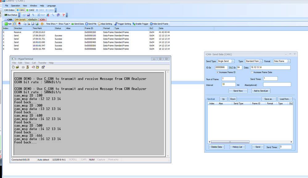

andreaskneissl
In this project an acceptance filter is set to identifier 0x100 and the interrupt filter is handling status interrupts and error interrupts. When I am sending messages with other identifiers, I get an status interupt with status CCAN_STAT_RXOK. But the message I cannot read. When I remove status interrupt from my interrupt filter I get only interrupts for the identifier 0x100, what I expect.
1) Is there any way to get the message of identifier, which are not defined in a filter?
   -> status interrupt CCAN_STAT_RXOK -> read message from other identifier
2) How I can get every message received from the CAN-bus (no filter)

Hi Andreas Kneissl,
  You can configure the can in the test mode, and enable the basic mode.
   Please modify the code like this:

After modify like the above code, I can receive all the IDs.
The test result is:
Wish it helps you!
If you still have question, please let me know!
Kerry
