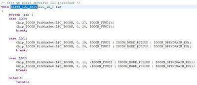

I have three peripheral on THREE different I2C0, I2C1,I2C2.
One EEPROM is connected to IC21 and another one on i2C2 with same chip number and Slave address.
Same API are used . but for I2C2 EEPROM " Write/Read Api " get stuck but I2C1 EEPROM works fine ??

And what do you see on the bus ?
6,423 Views

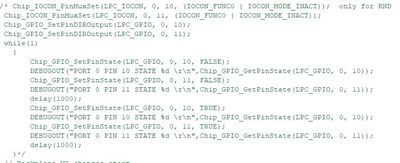

ankitvats
No transition on SDA and SCL line.
but I able to toggle  SDA and SCL pin mux as Gpio.
What to do next ??
 Toggling the pin.
and this for I2c muxed
6,418 Views

Did you check the pin initialisation code for the I2C1 and I2C2 pins is correct, and consistent with the datasheet/manual ?
Did you enable the clock to the I2C1 and I2C2 peripherals ?
6,389 Views
ankitvats
>>Yes , I check the Pins and Consistent with dataSheet.
I notice One thing That I2C2 is a peripheral of "APB 1 peripheral group"
Is there is Dependance to use these peripherals .??
 >> this function is used to enable clock for ALL 3 i2c.
STATIC INLINE void enableClk(I2C_ID_T id)
Chip_Clock_EnablePeriphClock(i2c[id].clk);
6,381 Views
Usually, each peripheral bus has it's own RCC register to enable/disable the clock to attached peripherals. And, each bus has it's own clock setup.
As said, I do not have a LPC1788.
I would check if this routine does enable the proper SYSCON flags, comparing with the MCU datasheet.
By the way, I would recommend to spend some time studying the datasheet in general.
Almost all IO pins in MCUs are multiplexed. You need not only to configure the GPIO pin and select the appropriate function, but also enable and configure the peripheral unit, which is I2C2 in your case.
This is highly specific for the vendor and the MCU family. I had dealt with a PLC546xx, were I2C functionality is provided by the Flexcomm peripherals.
6,327 Views
ankitvats
 Peripheral EEPROM on I2c 2 bus is working Now.
Enable the peripheral Clock by Adding clk Selection register   "LPC_SYSCTL->PCLKSEL2 |= (1 << 20);" in the API  "Chip_Clock_EnablePeriphClock(i2c[id].clk);"
